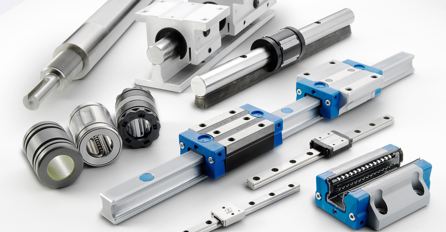

For linear bearing and guides, selecting the right lubricant at the outset is critical. Using the wrong one shortens operating life (best case) or causes catastrophic failures (worst case).
Selecting the appropriate lubrication for an application directly influences the performance and life of linear bearing and guides. (Courtesy:Thomson Industries)
A few general guidelines that will help you select the right option:

Linear slide tables should be lubricated per the manual. Using a different grease than what was supplied at the factory can cause the grease to degrade. Do not use any type of dry lubricant (PTFE or graphite powder) with recirculating ball- or roller-type bearings. Although these lubricants are good for sliding motion, they do little to reduce rolling friction.

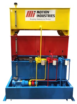

In the final stages of production, this custom-designed fluid containment system for a mining operation lets end-users identify and segregate each fluid by color to avoid any possibility of cross-contamination. (Credit: Motion Industries)

Proper lubrication storage and transportation is critical. This is why setting up protocols for them merits a significant investment in time, effort, and money. Color-coded tagging of containment and transfer equipment keeps storage clean and orderly. Positioned throughout a facility, this serves as a daily, visual reminder of that facility’s commitment to the program. It also cultivates a culture among the employees that values good maintenance.

  • Color code everything: storage tanks, transfer equipment, and even the equipment being serviced. For example, it would be a good idea to have a yellow grease gun, yellow outlined pegboard in a bulk-lubricant storage area, and a yellow tag showing the grease name and type hanging on all equipment it gets put in or on. Color coding for lubricant distribution makes for an easy-to-use and intuitive system. It may seem like a laborious task, but there are many ready-made labels and tags that can be quickly and easily ordered and installed.
