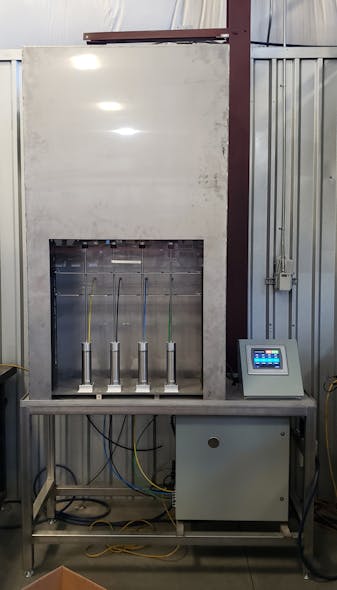

Several positioners from Anysize can be controlled by a single air line. Each positioner has only one moving part, the piston.

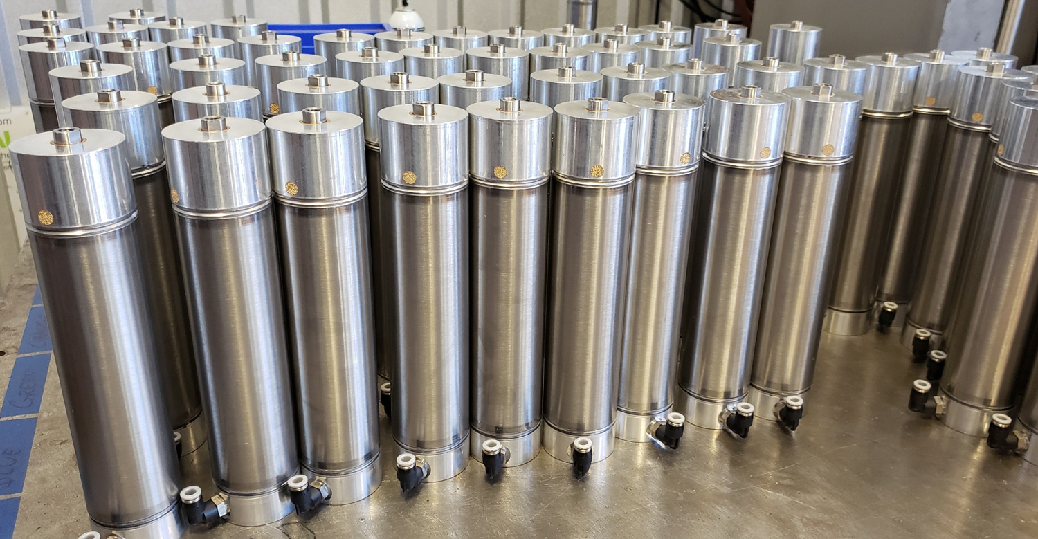

Biasers, usually springs that constantly put a force on the piston, are checked at the factory to ensure they are accurate.
The new positioners, dubbed Anysize, are generally comprised of a precise, high-rate wire coil spring “biaser” which provides a bias force on a piston within a cylinder. This piston is attached to a rod which protrudes from the cylinder end. The volume within the cylinder on the side of the piston containing the spring is vented to atmosphere. Opposite the piston is a volume filled with a fluid; for most applications this is simply compressed air. Air pressure is varied, which affects the force applied by the piston against the bias spring. The piston and rod move based on how much force (pressure) is applied to the spring. According to Hooke’s law, pressure is proportional to position.
Fluidic displacement for most applications is compressed air, however, hydraulic displacement also works and is included within the Anysize patent portfolio as long as the pressure is accurately controlled. The benefits of using hydraulics in lieu of pneumatics are stiffness and greater force. In practice, hydraulics are not used yet because the technology was developed for the food and beverage industry where end-users are concerned about contamination from hydraulic oil.
The Anysize positioner only ha a single moving part, the piston. In this version the spring acts as the biaser and air pressure controls the device.
Biaser is the terminology we typically use to describe the spring that puts the force on the piston displace, but it can be anything that changes length proportionally to force. Wire coil springs are ideal because they are relatively easy and cost-effective to make precise springs. When engineered correctly, wire coil springs have an infinite life cycle and the spring rate does not change over time. They also tend to have a mostly linear displacement. The downside to wire springs is that they can take up more space than other biasers.

Because the positioner we were developing would be used in applications required hundreds of them acting in unison, air pressure was chosen, because changing pressure in a single line changes the pressure going to each positioner at the same time.
Moving beyond Westinghouse’s invention, we precisely match the springs and the pressure so that the positioners continue to move in unison to a desired position. In essence, pressure equals position. A long line of Anysize positioners can easily be controlled by a manual pressure regulator and recent developments in proportional pneumatic regulators make it possible to precisely control air pressure electronically from a PLC and integrate hundreds of positioners into a system.
