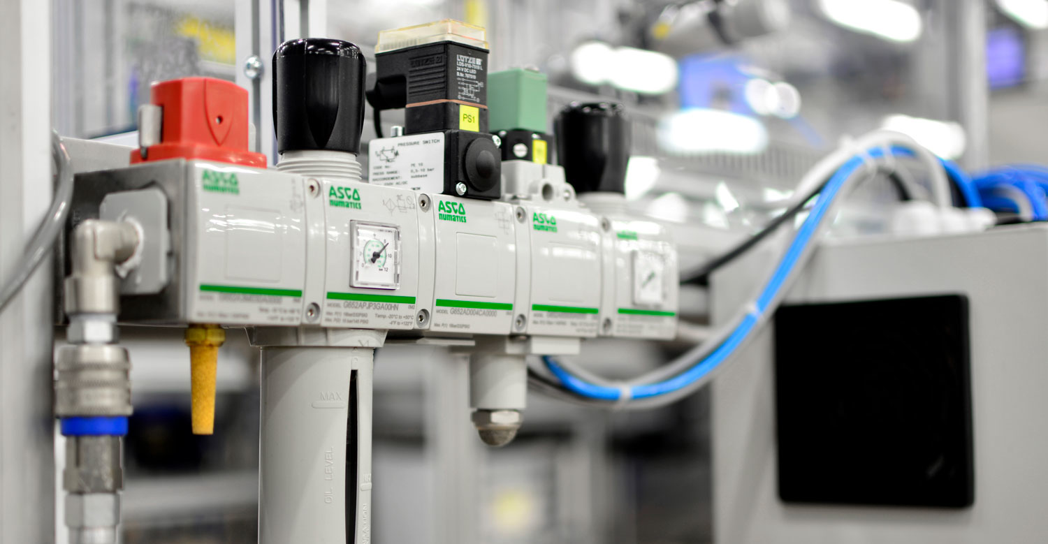

FRLs, such as this ASCO Numatics 651/652/653 Series air preparation manifold, are often the forgotten parts of a plant’s pneumatic system, but they have a big impact on machine efficiency and productivity.
FRL 101:The Basics
FRLs provide point-of-use control of air pressure and cleanliness in pneumatic networks. They are located upstream from the directional control valves, manifold, cylinders, and actuators. Virtually every pneumatic device requires some type of air preparation and pressure control.
Today’s FRLs use modular components that are placed in-line in one assembly. Typically, after the shutoff valve, the filter is the first component in the air line; then the regulator; and finally, the lubricator.

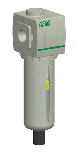

Filters are available in different varieties to let them remove oil, particulates, water, and odors from the compressed air. Particulate filters remove particles from the air stream and are available in pore sizes of 5, 25, and 40 microns. Coalescing filter pore sizes are smaller, ranging from 0.01 to 1.0 microns, to extract moisture and oil drops that can impact pneumatic performance. Adsorption filters, although rarely used, employ activated carbon to eliminate odors and residual oil vapor in the air.

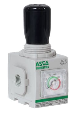

Regulators set the incoming air pressure to the desired level for the cylinders and actuators operating machinery. Because pressure in the plant’s air drops frequently and varies, consistent pressure regulation is essential to ensure appropriate machine reaction times and speeds. The regulator is typically set slightly below minimum plant air supply pressure. Regulating to the correct pressure for the application also allows users to optimize energy consumption.
The ASCO Numatics 653 Series of air preparation products from Emerson lets users power more products from the same Filter-Regulator or Lubricator (FRL), or reduce pressure drop across the system, both of which can save energy and costs.
