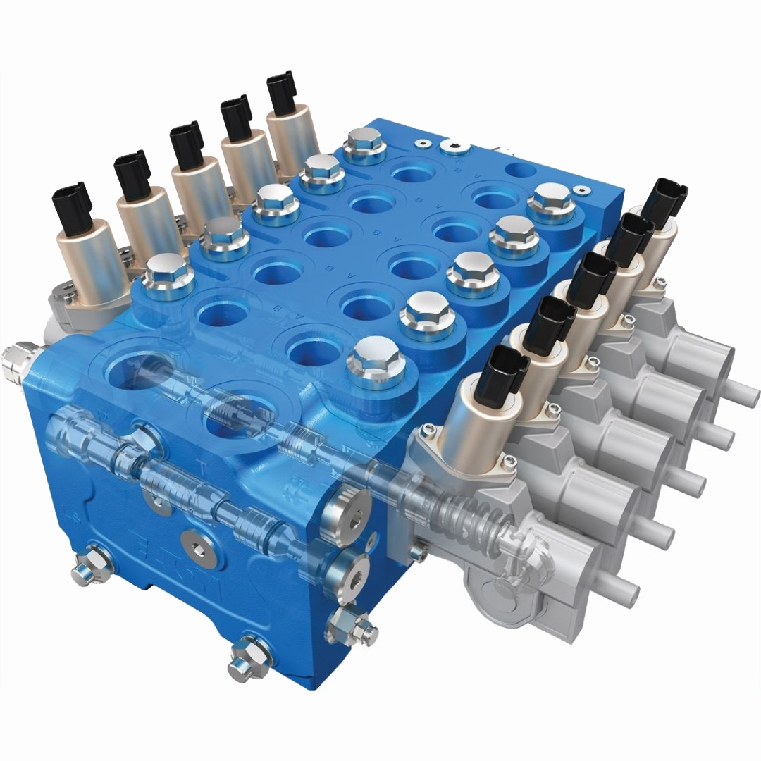

For example, the new Eaton CLS load sense sectional mobile valve offers an advanced version of this configuration. By providing for pre- and post-compensation in a single valve, plus the ability to configure and control, valves like the CLS can be a valuable option for machine designers that require versatility in their applications.
Eaton’s CLS 100 load sensing sectional mobile valves are a pre- and post-compensated mobile valve family with a highly versatile design.
