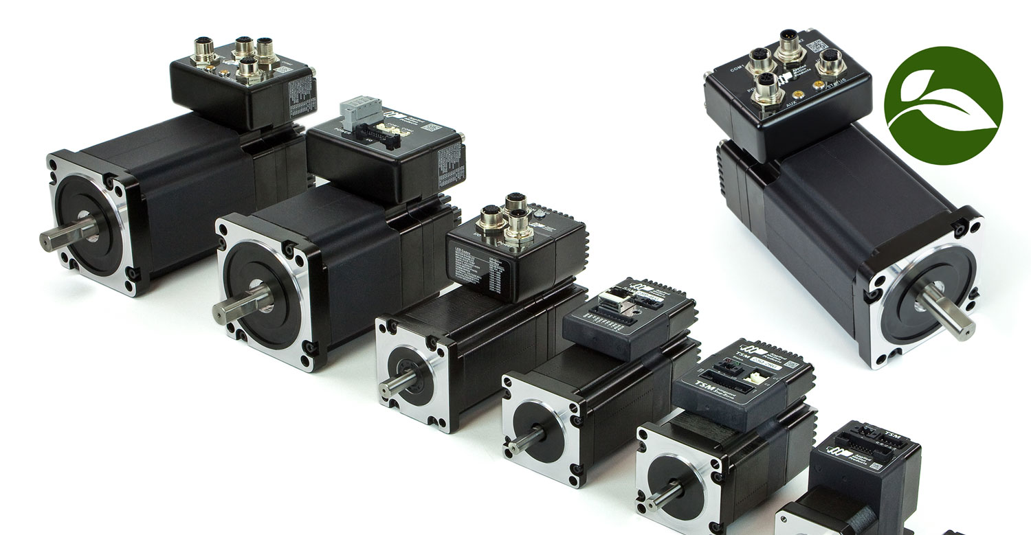

StepSERVO Integrated Motors offer numerous benefits over traditional, open loop step motors systems including higher torque, faster acceleration rates, greater throughput, reduced noise, and greater efficiency.

A side-by-side comparison of StepSERVO closed loop and open loop step motors is used to show performance differences such as the increase in energy efficiency provided by closed loop motor and drive systems.
