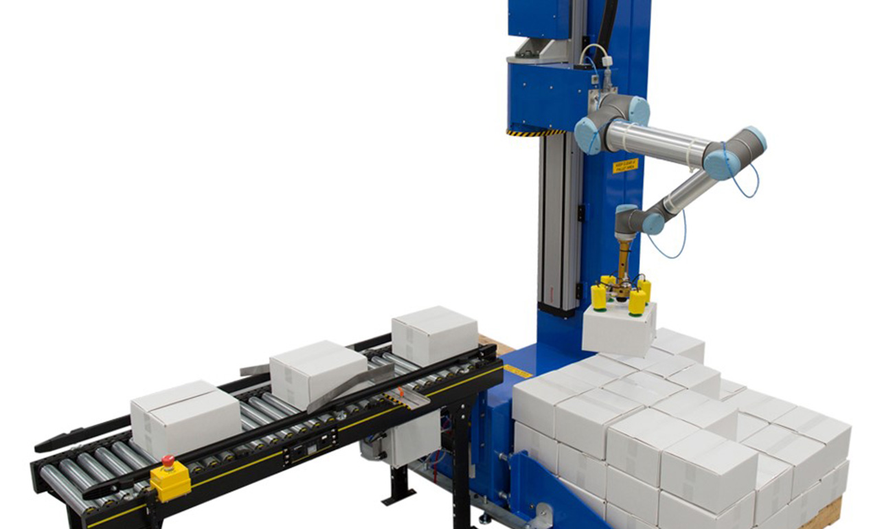

Universal Robots: Zero Footprint Palletizer
Attendees at ATX West show, held in conjunction with MD&M West from Feb. 6-8, will get a hands-on experience of how user-friendly collaborative robots—or cobots—can now safely and effortlessly automate some of the most common manufacturing tasks in the industry. Universal Robots’ ATX Booth 4616 will be the launching pad for the Zero Footprint Palletizer (ZFP), which is ready for distribution in North America through Apex Motion Control.
The ZFP is a simple solution for mid-rate production at a maximum load of 18 lbs. The system can be easily redeployed throughout a facility, and fits into existing packaging lines without modification, replacing manual palletizing operations in minutes. The new ZFP has a vertical 7th-axis swing system with the ability to stack on each side, supporting North American pallet sizing.
“The UR10 arm was chosen for this solution due to its ease-of-use and safety features,” says Rob Antonides, President of Apex Motion Control. ”We deliver automation solutions for the food industry and saw a clear market need for a flexible automation solution that addresses high-mix/low-volume runs in space-restrained spaces.”
The ZFP can operate with no guarding. If an operator is detected in the carton pickup area, the collaborative safety features of the UR10 will reduce the speed of the robot until the area is cleared while the zero-pressure accumulation infeed conveyor controls the flow of the product.
