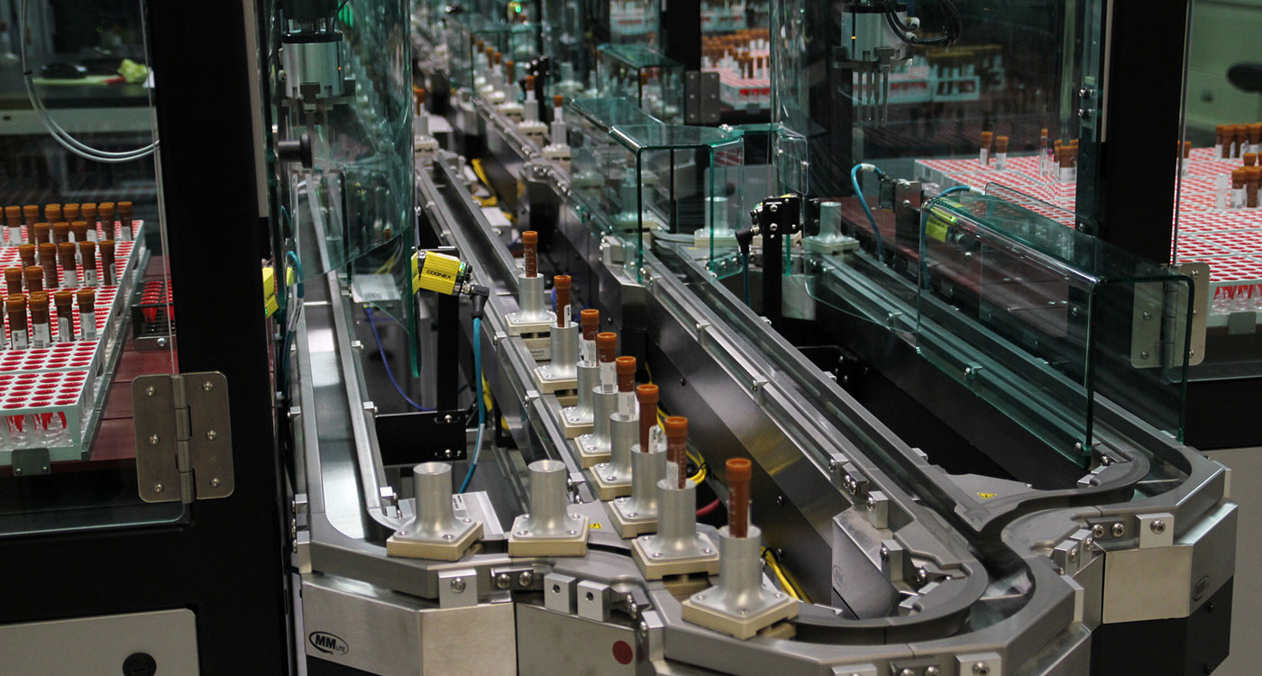

A smart motion system is an intelligent track or conveyor system that uses programmable independent movers on a straight or curved track. These systems can be scaled to a wide range of needs, from high-performance, in-machine production to the transport of products between facilities. These systems also support greater traceability in industries like food and beverage, automotive, or as shown above, life sciences.
One example of smart motion is an intelligent track or conveyor system that uses programmable independent movers on a straight or curved track. These systems can be scaled to a wide range of needs, from high-performance, in-machine production to the transport of products between facilities. And they are already helping reimagine motion applications, from packaging and pharmaceutical production to 3D printing.
