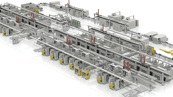

Automobile manufacturers boost flexibility by switching to production with linked machining centers as seen in the image above. Machining centers permit faster reaction to fluctuations and changes in demand, the machining of different versions of a workpiece without retooling on the same production line (version flexibility), and the adding or removing of machines relatively easily to and from the production line (reuse flexibility).
Representation of a modern production line with linked machining centers. (Courtesy of MAG IAS GmbH)
