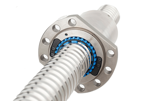

Steinmeyer’s UltraSpeed return system uses through-the-nut technology. Axial deflectors (the two black pieces on the end of the nut) send balls recirculating back through the nut, helping give the screw a speed rating (DN) of 160,000.

Through-the-nut (“UltraSpeed”): Through-the-nut returns were originally developed for high-speed operation of high-lead ball screws. The UltraSpeed, for example, uses deflectors at each end of the nut. Balls get lifted off the shaft, guided through a bore inside the nut body, and set back onto the shaft. One pair of deflectors serves one circuit, which includes several turns.

This nut design is normally used for lead/diameter ratios greater than 0.5 and dual start threads (that is, two separate thread paths on the shaft) It can reach a DN of 160,000. This speed corresponds to more than 90 m/min (1.5 m/s). Dual-start threads are typically used for vertical-axis applications because two deflectors per start provide redundancy against failure.
