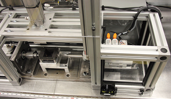

An electropneumatic positioning system (EPPS) automates a process for pressing bushings into housings.

For example, a mechanical-components OEM turned to the EPPS to automate a press that’s used in an assembly process for installing bushings in housings. The press is designed to handle two different sizes of housings. The smaller housing requires two pneumatic cylinders to press two sintered bronze bushings into place, one on each side of the housing. The machine simultaneously installs both bushings in a single operation.
A larger housing requires three bushings to be pressed into place. As with the smaller part, a bushing is pressed into each side of the housing. However, for the larger unit, a second operation is needed to press the third bushing in place inside the housing—a cumbersome and tricky task when performed manually.
To speed the process and improve quality, the manufacturer chose the EPPS system to precisely and quickly press the bushings into the proper positions. The operator selects the required housing size via an HMI; a PLC then sends a command signal to the EPPS controller (EPPC) and on to the electropneumatic control valves, ultimately controlling actuator position during the pressing operation.
The system uses two ED02 electropneumatic pressure-control valves and two PRA pneumatic ISO piston-rod cylinders for pressing, plus a third cylinder for clamping parts in place. In addition, an RTC rodless cylinder opens and closes an operator safety shield.
The OEM automated this process to ensure accurate bushing placement, reduce the cycle time for the operations, and improve operator ergonomics. Results show the bushings are precisely mounted with less effort and fatigue, and cycle times decreased about 30%.
One final note: When designing the automated press, the company’s manufacturing engineers considered an alternative system using an electric servodrive. The EPPS system won out, based on an estimated cost savings of approximately 40%.
