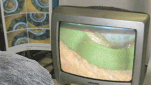

Micron-thin dry films can be applied to tolerances that are more common to plating. For instance, bonded to the cup side of tiny bearing retainers to a thickness of 0.0003 to 0.0005 in., lubricant film is applied with tolerances of ±0.0002 in. Small gears, clips, valve slides, grippers, and probes can be similarly coated to prevent interference with their intended motion.
If necessary, each part can be inspected both microscopically and with a laser micrometer to ensure that no irregularities exist on the bonded surface.
