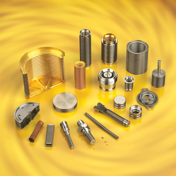

Electrodeposited bellows like these examples are produced by plating metal (most often copper, nickel or a nickel alloy) onto a bellows-shaped form (mandrel), and then removing the mandrel using chemical or physical methods. This technique lets manufacturers carefully control the bellows wall thickness and produce bellows with tiny diameters and superthin walls.
Similarly, the demanding nature of most semiconductor processing environments dictates that metal bellows can be fabricated from special materials. For example, some semiconductor applications require a bellows manufactured from a nonmagnetic material. In others, the existence of corrosive process gases can impose strict material requirements or constraints. In general, metal bellows are produced using one of three main techniques: electrodeposition (also called electroforming), edge welding, and hydroforming. Each technique has advantages and disadvantages. Among the manufacturing methods available, electrodeposition and edge welding are both widely used to produce the bellows needed for semiconductor manufacturing and UHV applications.
Electrodeposited (also called electroformed) bellows are produced by plating metal (most often copper, nickel, or a nickel alloy) onto a bellows-shaped form (mandrel), and then removing the mandrel using chemical or physical methods. These techniques can let manufacturers carefully control the bellows wall thickness and produce bellows with tiny diameters and super-thin walls (on the order of 0.0010 to 0.00010 in.). At these dimensions, the resulting miniature bellows are extremely sensitive and well suited for precision instrument applications. They can also provide large deflections in response to the application of small forces (as low as 4 g).

By comparison, edge-welded bellows can be made from more than a dozen materials including stainless steel, Inconel, Hastelloy, titanium, and others. They are produced by welding metal diaphragms that have been stamped from strip material using plasma, laser, arc, or electron-beam welding methods. Compared to electrodeposited bellows, edge-welded bellows are stronger and more robust. However, this edge welding can’t produce bellows with extremely small diameters or thin walls.
Compared with those produced using the other fabrication methods, edge-welded bellows have the highest stroke length (reaching 90% of their free length) and enjoy excellent compression capabilities, allowing for a lot of expansion and contraction during operation. And with a greater variety of metallurgical options available, edge-welded metal bellows can also withstand exposure to extremes in liquid and gas media and temperatures.
