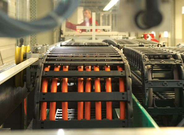

Another rule of thumb for continuously flexing applications is that cables shouldn’t exceed 325 ft. (Stationary applications tolerate longer runs.) Cables that are as short as possible reduce cost and transmit at a more stable voltage than longer runs. However, in long cables especially, high capacitance can cause reactive currents that tax the drive. Then, because of the drive’s overcurrent limit, sometimes it’s impossible to feed the motor enough power.

Like any cable, hybrid servocables must withstand the application’s movements, including their length, speed, acceleration, and bending radius. Static applications are more forgiving unless the installation space requires that cables bend or twist around obstructions. Dynamic applications involve constant flexing and usually need specialty conductor stranding, insulation, and jacket materials, plus tracks to keep cables untangled.
