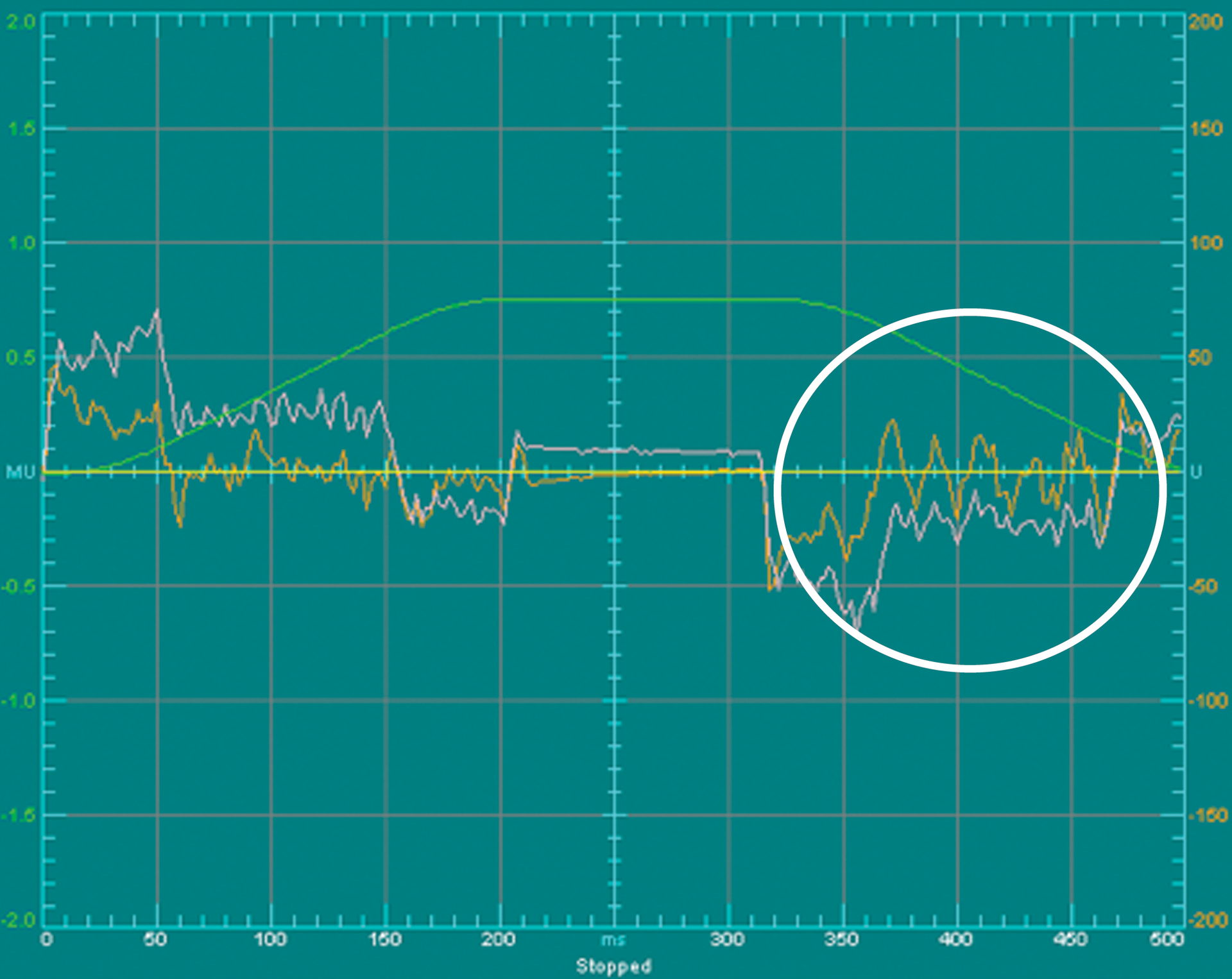

In Fig. 4, testing is executed using a Parker Trilogy 404LXR linear motor with Aries controller.
First, both the disturbance observer and integral control are turned off. Then the system is accelerated and decelerated.
As expected, there is steady-state error (circled in white). The yellow line is the commanded position; the green line indicates actual position; the brown line shows the following error, and the pink line represents the control output.
In Fig. 5, the disturbance observer is turned off. Integral control is turned on.
The steady-state error can be removed — but at the cost of bumpy following performance and a system stability violation caused by integral windup.
In Fig. 6, the system is accelerated and decelerated with a disturbance observer applied.
Steady-state error is removed, and following performance is smooth and controllable.
