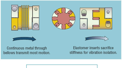

A: If a coupling is made stiff enough, resonance effects can almost be eliminated. But weight limitations sometimes require lighter-weight (or lighter-duty) components — with lower rigidity and more instability — when servo gains are raised. (Reducing coupling compliance often leads to greater material mass, which is why high torsional stiffness relative to size is so important. If we may invent a unit of measure, a higher amount of Nm/rad/kg is normally desirable.) For example, bellows-type servocouplings are used when shaft alignment is kept within fairly reasonable tolerances because they are lightest and most torsionally rigid.
Fortunately, economy bellows coupling designs have become available in the last few years, reducing the tendency toward undersizing for cost. Since bellows disc and beam couplings are typically constructed from steel and other metals, their vibration-damping capabilities are minimal at best. In cases where torsional stiffness must be compromised to compensate for greater misalignment, a flexible disc or beam type is more appropriate. The best way to avoid vibration failures with these couplings is to minimize system vibration, possibly by resizing the coupling itself.
Q: What to do when resonance is a problem?
A: For resonant vibration occurring torsionally or with high-impact loads — which excite all system frequencies — elastomer-insert couplings offer the highest damping without introducing backlash. The couplings typically come in four shore hardnesses, depending on the level of damping required, or the amount of acceptable torsional compliance. Most manufacturers offer 98A, 90A, 80A, and 64D-hardness inserts. The industry standard, 98As though 64Ds, offer increased hardness and consequently torsional stiffness. Other hardnesses are specified primarily for special applications.
While their static torsional stiffnesses are about 50 times lower than those of rigid bellows couplings, elastomer insert couplings always settle to their original angular position, eliminating positioning error. In fact, this is adequate in most cases.
