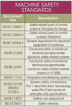

Machine Safety Standards
In the United States, the Occupational Safety and Health Administration (OSHA) and the National Fire Protection Association (NFPA) administer machine safety standards. Overseas in Europe, the International Electrotechnical Commission (IEC) and the International Organization for Standardization (ISO) are used as the barometer for regulation standards, which are applied at a global level for other countries like China, India, and the U.S.
The multitude of agencies and standards may confuse machine builders and engineers in cases where hardware can fall under more than one standard. If an injury occurs within the U.S., would OSHA investigate and inquire if the machine was as safe as possible? Prior to 2012, a programmable logic controller (PLC) could be built to comply with the European Union’s Machinery Directive (EN/ISO 13849-1) but not comply with the NFPA 79, the U.S. equivalent that addresses safety-rated PLC and safety buses. This muddies the waters for engineers trying to build devices that follow the proper safety regulation.
Another hindrance is the current state of safety regulation. Since the 1970s, machine safety standards have been slow and not kept up with the technology. Before 2002, all hardwired components were required to use emergency stop pushbuttons. This diminished the flexibility to reduce production downtime; it was not until after 2002 that users were allowed to use safety PLCs and software-based controllers.
Similar problems were occurring in Europe, as the EN 954-1 safety standard did not cover programmable electronic safety equipment or failure probabilities as far back as 2009. In 2011, the EN ISO 13849-1 and EN 62061 replaced the EN954-1 that covered all machine and process safety systems sold within Europe.
In the last 10 years, we are seeing safety-standard updates being applied to all major manufacturing countries. Sean O’Grady, a Product Manager of Valve Terminals and Electronics from Festo, says that “Globally, many countries and industries have taken advantage of the groundwork created by the European Union (EU) machine directive of 2006. For instance, EN ISO 12100 covers general principle of design for machinery safety, while EN ISO 13849-1 deals specifically with safety-related parts of control systems. Within the U.S., for example, various regulations and industry standards reference these documents directly.”
EN ISO 13849-1, for instance, applies to many technologies, including electrical, pneumatic, hydraulic, and mechanical. This standard provides requirements for the design and integration of safety-related parts of control systems, including some software aspects of safety-related systems. It can also be applied down to the component-parts level of the system.

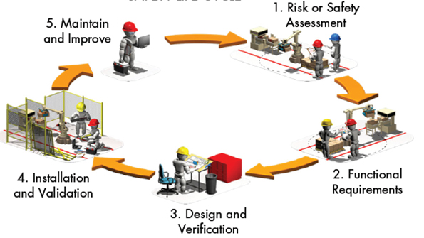

The risk-assessment lifecycle is designed for continuous improvement of the safety program. (Courtesy of Rockwell Automation)

The Safety Life Cycle from Rockwell Automation is one example of a safety program, designed to implement safety procedures and increase efficiency of a production process. (Courtesy of Rockwell Automation)
One example of a safety program is Rockwell Automation’s Safety Life Cycle. Rockwell Automation utilizes different safety methods and procedures to help reduce the time to design and develop safety solutions. The Safety Life Cycle improves safety by identifying the steps required to properly assess and mitigate any risks.
The first step is to perform a hazard or risk assessment by identifying hazards and estimating their associated risks. The next step is determining the functional safety system requirements, which involves evaluating safeguard options based on industry standards. Following that comes design and verification of the system. Designing systems includes planning the system architecture, document safety circuit design, and procure the appropriate materials.
Once the design is complete, the next task is to install and validate the system. This involves operating the system, ensuring that it responds correctly to failures and safeguards are in place. Once verified, the last step is to maintain and improve the system. Continued monitoring and recording of the system’s performance is essential so that the results can then be integrated back into the top of the lifecycle for a better risk assessment.

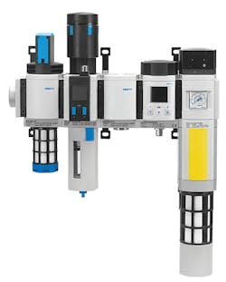

Festo’s MS6-SV safety valves offer the VOFA solenoid valve platform with spool-sensing technology for safe stop and reverse motion.
Festo, for instance, integrated safe inputs and outputs directly into its pneumatic-valve terminals. In the past, a machine designer would need to specify an appropriate safety relay or safe output, and perform all of the required safety calculation and documentation. The designer would then have to manage the proper installation, commissioning, verification, and validation of the resulting safety function to ensure proper function and legal compliance. By selecting an integrated solution, time and effort is reduced while also providing the designer with additional diagnostic capabilities and more complete documentation, which facilitates legal compliance.
