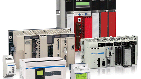

The Difference Between PLCs, PCs, and PACs
Essentially, a PLC is a ruggedized control device made up of a microprocessor, memory, and a variety of peripherals. PLCs typically use IEC 61131-3, an industry-standardized set of programming languages, including Ladder Diagram. Ladder logic, a language that reads the same as the electrical diagrams maintenance crews are already familiar with, makes the PLC a popular choice. Most developers and maintenance personnel have experience with programming and debugging Ladder, minimizing the need for training. Standardized programming ensures longevity as the machine can easily be serviced in the future, and reduces the dependency on the original programmer. The major limitation with PLCs is that they were designed to replace relays, timers, and I/O. This left their functionality limited when it came to the realm of motion control and visualization.
A programmable logic controller (PLC) is an industrial solid-state computer that monitors inputs and outputs, and makes logic-based decisions for automated processes or machines. PLCs were designed to replace relays, timers, and I/O.
Traditional PLCs typically rely on peripheral devices such as smart drives and stand-alone motion controllers to provide advanced functionality. A potential drawback of this motion-control architecture is the need to maintain separate programs for each device. Smart drives and stand-alone motion controllers often use proprietary languages, canceling out the benefit of using an IEC 61131-3 PLC in the first place.
