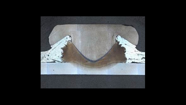

The figure above shows how the CFFs are installed. In step one, the specially designed fastening element is turned at high rpms while a modest axial load is applied. This effectively lets the fastening element pierce the aluminum top sheet and proceed all the way through until it meets the lower high-strength steel sheet. In step two, the fastener continues to rotate at high speed with some axial pressure to “clean” and prepare the high-strength steel sheet for friction welding. This is critical in getting a quality weld.
In step three, the axial load increases so heat generated by the friction of the fastening element turning against the steel sheet increases rapidly. The heat creates a plastic zone at the tip of the fastening element and in the affected area of the steel sheet. In fact, no pool of molten metal is created while these two plastic regions are welded together. The axial load compresses the fastening element into a secure welded interface between the fastening element and the steel sheet. Additionally, the axial load compresses the joint together so that it is solid and tight. The final step, number 4, involves a short dwell time to let the joint cool sufficiently before the axial load is released. The figure below shows a cross-sectional example of one of these completed joints. It clearly shows how the friction element “curls up” and bonds to the high-strength steel sheet as a result of the axial load exerted when the material is in its plastic state.
CFFs do require two-sided access. This means installation equipment has a driving unit on top and an anvil attached to a C-frame on the bottom. Although static (floor-standing) units are available, the technology is more likely to be applied by robots similar to those used in body shops  to make spot  welds. The installation cycle time should be similar to other automated joining technologies such as self-piercing rivets and clinching technology.

The obvious advantage of a CFP is that it requires only one-sided access. This can be a significant advantage for designers when they can’t get installation equipment into position on both sides of the components being fastened. Unfortunately, the CFP version is limited in that it only works in materials up to about 1,000 MPa. Above this strength, the steel component is too strong and hard to effectively pierce. The figure below shows the cross-section of a CFP joint.
