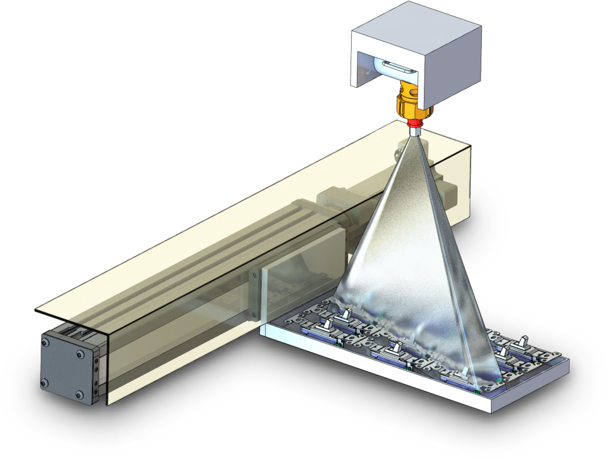

Some actuators, such as those that move products within the range of sprayed water, will be directly in the path of water. These devices should carry an IP66 or IP67 rating. Devices with these higher IP ratings will typically have redundant exclusion mechanisms such as shields, bellows, or guards, ensuring long-term operation. Again, rodless actuators will not perform well in these applications without customized protection.
3. The above application depicts a spray head with direct spray contact to the rodless actuator. The illustration on the left shows a rodless actuator with no shielding. The illustration on the right shows the proper shielding a rodless actuator would require for direct spray applications.
