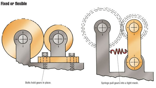

The simplest and most common way to reduce backlash in a pair of gears is to shorten the distance between their centers. This moves the gears into a tighter mesh with low or even zero clearance between teeth. It eliminates the effect of variations in center distance, tooth dimensions, and bearing eccentricities. To shorten the center distance, either adjust the gears to a fixed distance and lock them in place (with bolts) or spring-load one against the other so they stay tightly meshed.
Fixed assemblies are typically used in heavyload applications where reducers must reverse their direction of rotation (bi-directional). Though "fixed," they may still need readjusting during service to compensate for tooth wear. Bevel, spur, helical, and worm gears lend themselves to fixed applications. Spring-loaded assemblies, on the other hand, maintain a constant zero backlash and are generally used for low-torque applications.
