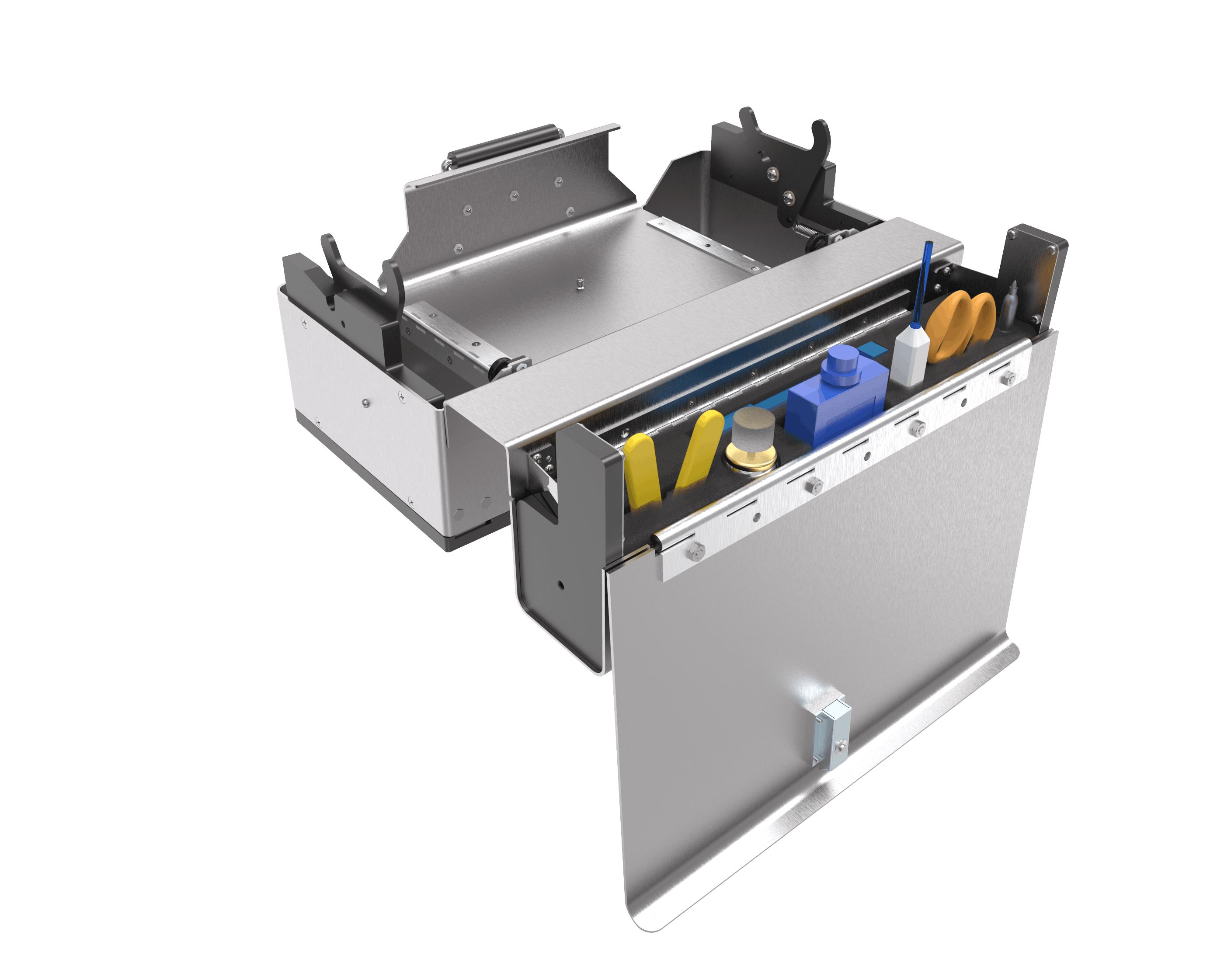

A team of engineers from Tennessee-based APTUS DesignWorks set out to improve the working conditions of these technicians by creating a briefcase that would allow for organization of tools and delicate materials while also providing a stable workbench to use high above the ground. The team collaborated with a company that installs the traffic cameras.
The goal of the project was to design a specialized, well-organized toolkit in the form of a metal briefcase. The briefcase would open to become a flat work surface where installers could safely lay their materials and ply their tools, then fold into a briefcase again for the ride down.

Briefcase-to-Workbench Design Challenges
Before a part hits the production floor, a few key design challenges would need to be solved—most importantly, the form-factor transformation from briefcase to workbench.
APTUS engineers decided to use strong but lightweight aluminum sheet metal fabrication for the bulk of the enclosure. They specified strict tolerances for gaps that arise when the toolkit is opening and closing, avoiding pinch points that could trap workers’ fingers. They also had to adhere to stringent bend radius requirements for the briefcase shell to soften its sharp edges and create a rounded, aesthetically appealing look in line with its client’s other products. And because the toolkit would be used near live voltage, the metal needed to be hard-anodized to reduce conductivity.
For parts requiring pliability—such as a pawl that engages with the teeth of a ratcheting mechanism, which APTUS designed to securely attach the opened briefcase to the lip of a work bucket—the engineers chose strong, low-cost ABS plastic manufactured through CNC machining. They also wanted to use the plastic to create a clamp for holding down the sensitive fiberoptic cable as technicians worked, and for a custom knob that was less bulky so it wouldn’t catch on any obstructions high above ground.
