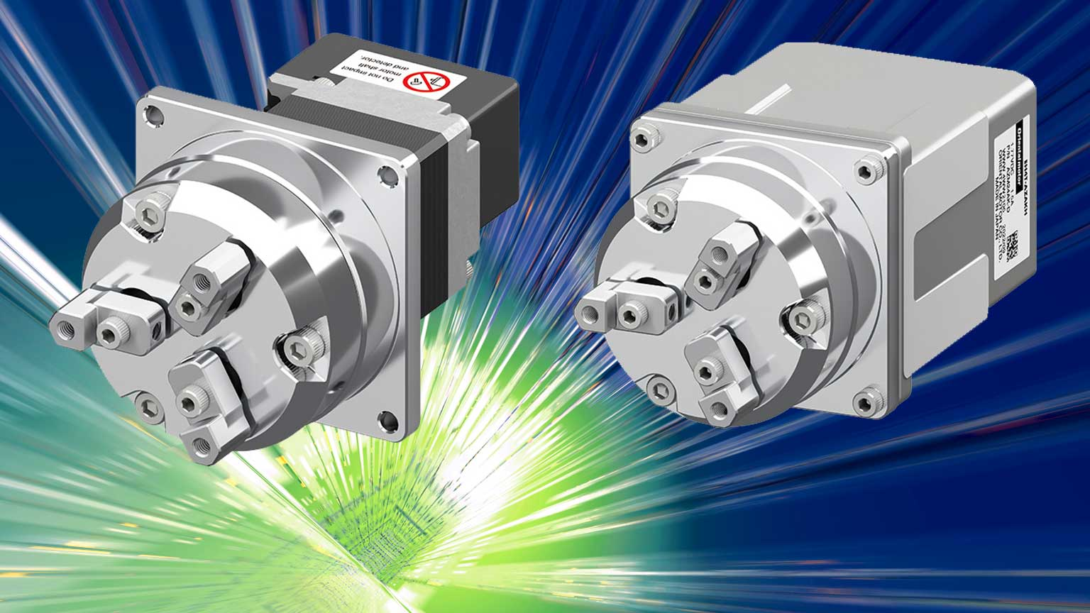

Oriental Motor’s recently released 3-Finger Type electric gripper can gently grip irregular shaped objects.
The EH Series 3-Finger Type electric gripper from Oriental Motor USA is capable of holding objects such as spheres and cylinders, mimicking the dexterity of human fingertips.
Key features of the electric gripper include:
  • Equipped with an αSTEP AZ Series motor
  • Suitable for gripping complex shapes
  • Maximum gripping force of 50 N (2-finger type: 25 N)
  • Compact and lightweight design, which reduces the burden on each articulation, decreasing the overall size and cost of the robot.

Customers have the option to choose between an installation cover or a no installation cover type, providing flexibility for different applications.
