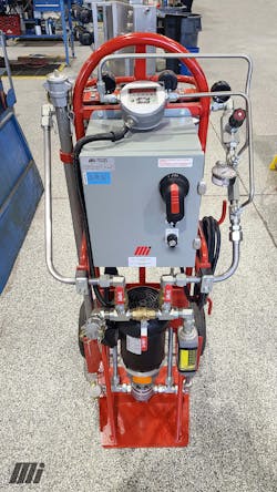

VFD use continues to grow in the OEM space for small and mobile equipment, which needs to be plugged into a single-phase outlet or in a commercial setting where three-phase power is less accessible. Examples include mobile pumping units, hose crimpers, lifts, actuator-driven devices, fans/blowers or any application where a motor is the prime mover and varying that motor’s speed would improve that equipment’s operation. Aside from the benefits of variable speed control, this increased use is driven by VFDs’ ability to use a single-phase power source while outputting a three-phase, current-controlled supply to the motor.
These may seem like small features at face value, but they hold much value, particularly for small-batch production. Outputting three-phase power means that standard three-phase induction motors can be used. These motors are both cost-effective and widely available. Control of the current can allow for many features that aid in the controllability of the motor, but it also allows you to avoid the inrush current that typically comes when starting an induction motor.
In context, when sourcing from a standard duplex 120V 15A receptacle, you would typically cap the motor size at ¾-hp to avoid nuisance tripping. When using a VFD, a 1.5-hp motor can be used in the exact application sourcing from the same plug. Doubling the available power of your prime mover in a situation like this can have obvious benefits for the functionality or capacity of a piece of equipment.

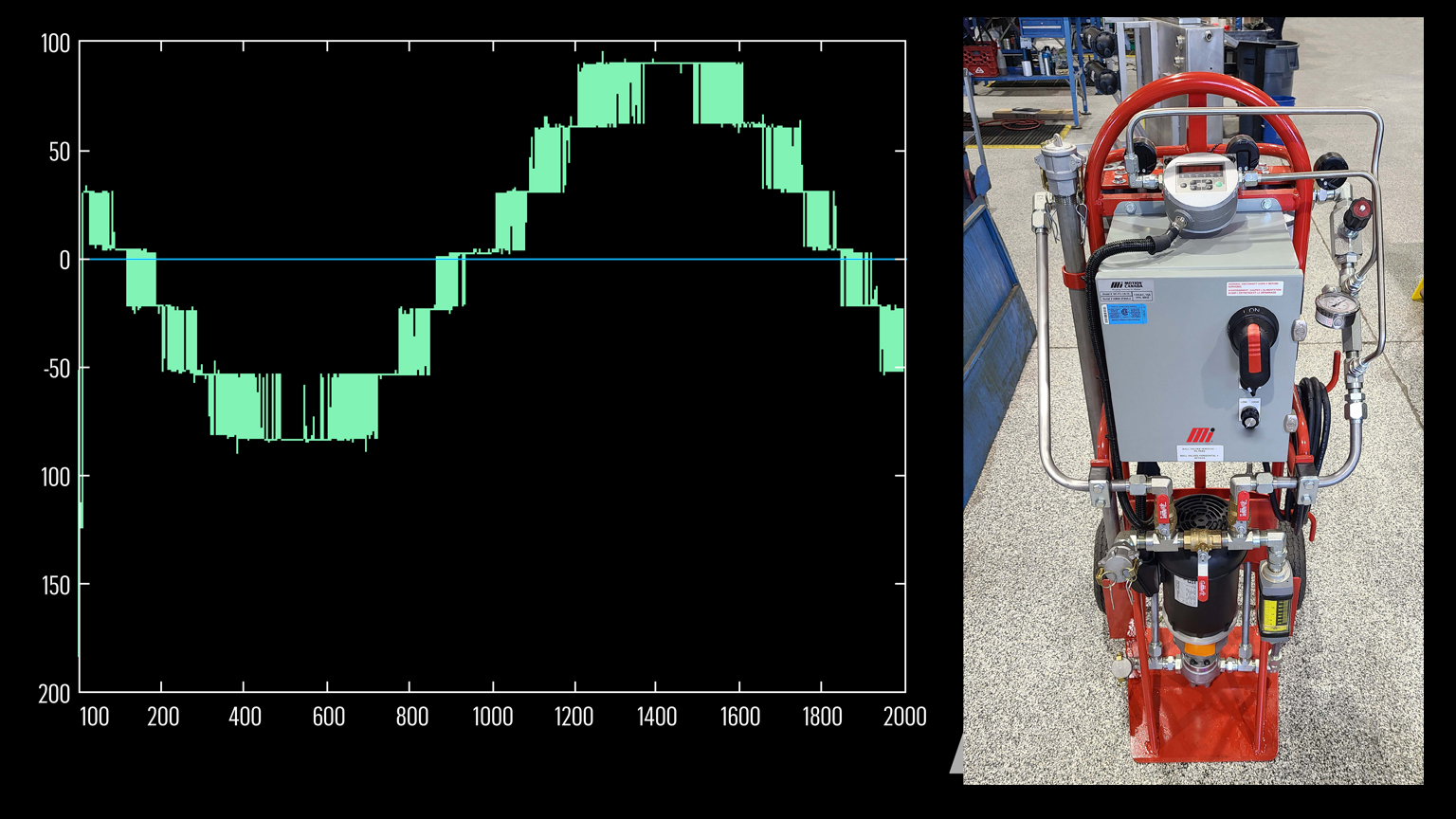

The reason that VFDs commonly trip GFCIs has to do with VFD construction and how it mimics an AC wave. A VFD can best be thought of in three parts. The first is the front end, which consists of a rectifier circuit. This takes incoming power and rectifies it from AC to DC. After the rectifier comes the DC bus, which feeds the final stage of a VFD: the inverter. This last part uses power from the DC bus to emulate a three-phase AC waveform that will power the motor. The issue that leads to VFDs tripping GFCIs is most closely associated with this inverter stage. This is because of the high-frequency harmonics caused by the solid-state switches that can lead to ground currents, also known as “common-mode noise.”
To understand common-mode noise, you need insight into how VFDs imitate a three-phase AC waveform. First, the frequency of the mimicked waveform is not what develops the noise. Rather, the problem is the switching frequency (also known as the carrier frequency) used to develop the waveform.
In a typical (grid-supplied) three-phase sine wave, you will always have a zero-sum after adding up all three potentials at any given point along all three waveforms. This is because each wave is 120 deg. out of sync. The concept can best be pictured as a circle divided into three equal sections (like a pie with three large slices) with a mark placed at the circumference where each region interfaces. If you centered that circle on a set of Cartesian coordinates with the center set at zero, the top of the circle at 1 and the bottom at −1, the same would be true.
As you spin that circle, you will find that the sum of all three points will always equal zero at any time. This is analogous to what you would see when charting three-phase power; likewise, this happens as you turn a three-phase generator in real time. The common-mode noise issue comes into effect as the waveforms generated by an inverter do not sum to zero in this same manner.
These waveforms do not sum to zero because most inverters use a multilevel chopper circuit to mimic or approximate the waveform. Because of this rough method, the difference between the actual waveforms as charted in real-time will not sum to zero. This leads to a difference of potential at any given instance and will lead to capacitive induced currents. These currents will seek a path to ground, which can trip a GFCI device.
