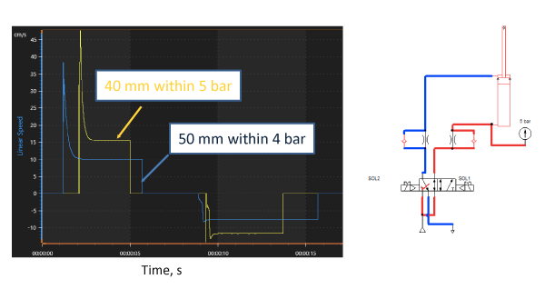

In practice, the correct choice of the cylinder diameter does not impact its functionality, but it does have an impact on the energy consumption. The Direktin tool demonstrates that the poor sizing of a cylinder’s diameter can lead to an increase of energy consumption up to 40%.

When a cylinder is already installed, users can always check if the system is oversized by using the above-mentioned tools. In this case, users can save energy on their systems by reducing the pressure levels.
This solution, however, is not optimal, as it requires additional pressure reduction, and the energy savings are lower in comparison to a correctly sized cylinder. Moreover, dead volumes influence the velocity performance for the studied application (Fig. 5); the velocity of the bigger drive with reduced pressure is lower. The primary reason is dead volumes, which are about 10 % of the piston volume. The value of dead volume gains with each cylinder size increasing filling time and, therefore, motion cycle.

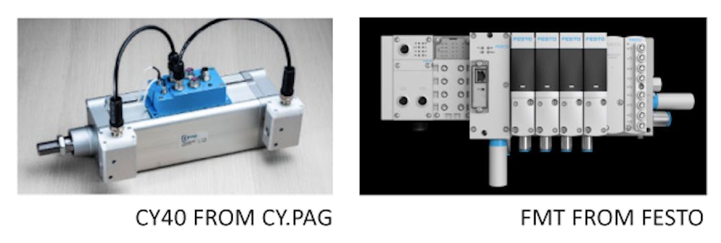

Advantages of a bridge circuit were implemented in commercial solutions by industrial manufacturers Festo and Cy.Pag, which offer different solutions with significant energy savings, embedded monitoring and other options.
FMT from Festo represents a control block of valves with various functions to operate a pneumatic cylinder, whereas Cy4.O from Cy.Pag is an intelligent actuator designed to monitor and optimize the filling of pneumatic cylinder chambers, effectively transforming the traditional pneumatic actuator into a pneumatic actuator that respects Industry 4.0 principles.

In this particular case, an alternative control strategy by means of bridge circuit (CROV) performs higher savings. However, lowest pay-back shows the use of reduced pressure return. An alternative diameter of 45 mm can be used for this case and promises 25% of energy savings, with less than one year return on investment. Tube length reduction is always a good option for more detailed tube sizing. (Pressure loss calculations are outside the scope of this article.)
