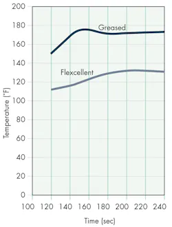

On the performance side, S.âS. White Technologies, Piscataway, N.â J., has developed a permanent lubrication system called Flexcellent that extends the endurance life of flexible rotary shafts. It combines a dry-film lubricant and aerospace-grade grease. The combination extends endurance life by slowing temperature rise. In aerospace applications, results show it significantly reduces downtime and repair and maintenance costs.
