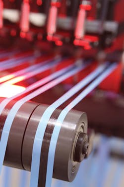

Until the 1970s, glass was typically added during an extrusion process. There are a great deal of shear stresses involved in getting the glass fibers into the resin and making sure it is fully mixed—or wetted out—into the polymer. This would cause the glass fibers to break into relatively short lengths (typically under a millimeter). To work as reinforcement and improve performance by 300% to 400%, the fiber should have an aspect ratio of the length to diameter of about 20 to 1.
By late 1979, plastics manufacturers started producing long fiber with a drawing process. Fibers up to 12 mm could be produced in pellet form. During an injection-molding process, there are shear forces that break long fibers. But post-process lengths in excess of 8 mm are normal.
Long fiber increases stiffness, strength, and wear properties. (Data courtesy of PlastiComp)

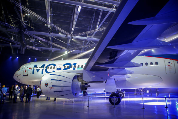

The wingbox is on the underside of this Russian MC-21 between or connecting the wings. This is the first time a composite has been used for this structural design.
“We used a unidirectional ‘dry’ tape for the box structure of the skin, stringers, and spar of the wingbox for the MC-21 Russian plane that rolled out June 8,” notes Frank Nickisch, global strategic projects director for aerospace at Solvay. “Our TX1100 textile is a dry, unidirectional tape that was cut into ¼-inch (6-mm) strips. It is able to be placed by a tabling machine. Controlling fiber direction with automated equipment, such as the tabling machine, is the next step in the fiber or textile design and fabrication for composites. The entire lay-up is then injected with PRISM EP2400, a toughened infusion resin.”
Unidirectional tape could take more time or labor compared to textiles or cloth composite. However, it offers strength to weight benefit desired by higher-end applications; for example, in performance racing and the aerospace industries. (Courtesy of Solvay)
Aviation Week noted the aerospace material trends around the choice of MC-21: “United Aircraft Corp. (UAC) has bet high on lighter-weight materials: an all-composite high-aspect-ratio supercritical wing has been designed for maximum aerodynamic efficiency in cruise flight. Other composite components include the center wingbox as well as the vertical and horizontal fins. The wingbox and the wing panels are produced using vacuum infusion technology at AeroComposit in Ulyanovsk, another UAC subsidiary.”
