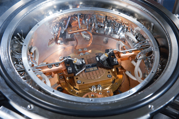

The high-speed silicon-germanium chip sits in a cryogenic station connected to several measurement probes.
