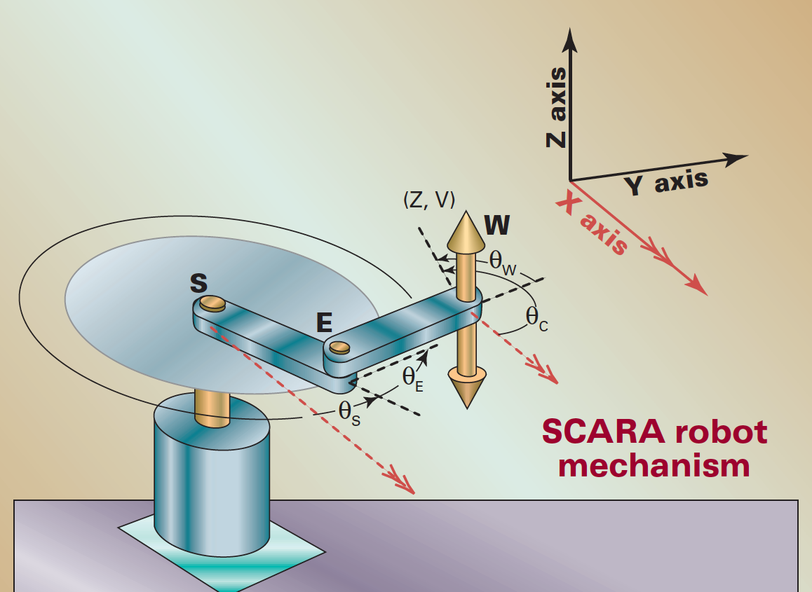

As an example, let’s consider the common SCARA robot. This mechanism has three parallel rotary joints turning about vertical axes — shoulder S, elbow E, and wrist W — and a single linear joint V in the vertical direction. The tool tip therefore has four degrees of freedom: three translational (X, Y, Z) and one rotational (C rotating about Z).
Four major motions: Shown is the inverse-kinematic subroutine computing the four motor (joint) positions from the tool-tip coordinates.
Limiting ourselves to positive values of the elbow angle θE that produce the right-armed case (done by selecting the positive arc-cosine solutions) we can write the inverse-kinematic equations as shown in the figure here.
Even this simple mechanism brings to light a couple of tricky issues commonly encountered with non-Cartesian mechanisms. The first problem is that there can be multiple solutions to the inverse-kinematic transformation: in this case, the right-armed and left-armed configurations. (Here, “right-armed” refers to the counterclockwise bend of the elbow joint, which looks like a human’s right arm from the top view.) Some method must be used to select which is used.
Also, there are some cases for which there are no possible solutions, no matter how far the joints can move. These must be handled — in this particular case, by recognizing that the argument for the arc-cosine function is out of the valid range of 1.0, as would happen at a physically unreachable tool-tip position. When the arc-cosine result for a certain input is invalid, it implies that the arms can’t move to that point.
