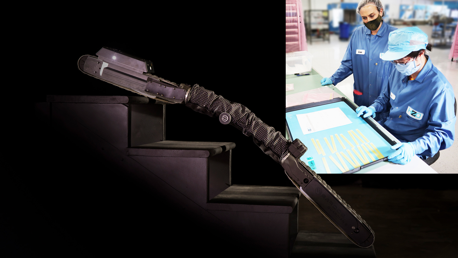

A case example of the efficacy of Parylene is Sarcos Robotics, a Salt Lake City-based manufacturer of industrial robotic systems that augment human performance by combining human intelligence, instinct and judgment with the strength, endurance and precision of machines to enhance employee safety and productivity.
The Sarcos snake-shaped Guardian S remote visual inspection and surveillance robot is a robust, multi-purpose, man-portable mobile IoT platform that carries multiple sensor payloads, providing real-time information while keeping the human operator out of harm’s way. The Guardian S robot is optimized for unstructured and unpredictable environments and designed explicitly to navigate uneven, challenging terrain and access small, confined spaces.
Built to go where humans couldn’t and shouldn’t, it inspects conditions of hard-to-reach assets in confined spaces to identify contaminants in unsafe, heavily polluted environments, detects chemical spills in manufacturing facilities, collects HAZMAT readings inside pipes and tanks, and other dangerous situations. The main function of the Guardian S is to save lives and prevent injury.
The engineering team at Sarcos kept that requirement in mind when considering printed circuit board assemblies’ potential exposure to liquid levels greater than two inches deep. Traditional mechanical seals were not reliable enough, and the traditional dispense solutions they explored did not deliver. The team also knew that HZO had the reputation and the chemistry to solve a variety of waterproofing and corrosion prevention problems.
HZO recommended Parylene coatings. They are extraordinarily thin, smooth, chemically inert and possesses dielectric properties—and can conform perfectly to a substrate because they adhere to it molecule by molecule. Sarcos sought to stretch Parylene protection boundaries for the Guardian S, so HZO took all the technical specs, conducted a range of rigorous experiments and increased the thickness of the Parylene to develop a superior protection bubble. To date, Sarcos has had zero product returns attributed to coating issues.
