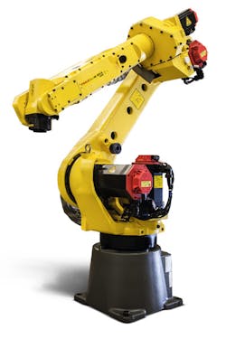

FANUC M-20iA
The system uses a FANUC M-20iA robot to pick various sized cartons from a conveyor and side-load them into large shipping cases. Meanwhile, a large, high-speed SR 3600 case-and-tray packer from Edson leverages Festo IO-Link at its Ethernet valve terminals to control the pneumatic operation. System sensors connected to a power supply use Balluff IO-Link to provide continuous measurements of diagnostic and statistical information. A barcode reader from SICK is used to determine whether cases meet user-set requirements as they are discharged from the packer.
