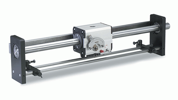

The rolling ring-drive housed in the drive head converts rotary motion of the shaft to linear motion for the drive head. In a packaging device, the head might hold a blade for cutting boxes or an adhesive applicator for laying down a bead of glue.

The drive head’s travel speed and direction are mechanically controlled with hardware fittings (end stops) that pivot the rolling-ring bearing assembly inside of the head.

The linear speed of the drive head can be adjusted using a lever. It pivots the rolling-ring bearings inside the head to increase or decrease the pitch and, therefore, the drive’s linear speed.
