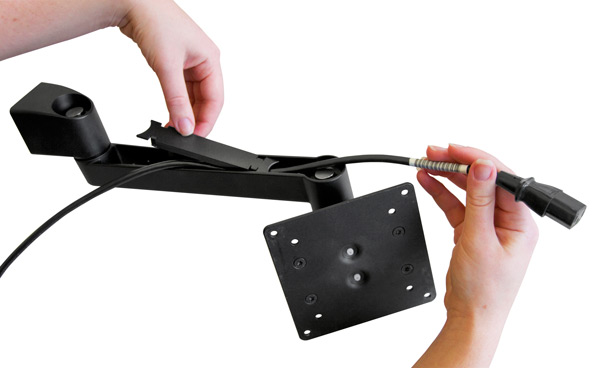

HFE is best described as the study of how humans use and interact with technology and equipment. For medical-equipment designers, HFE guidelines involve the equipment, the places it will be used, and limitations of patients and health-care workers operating the equipment. The guidelines address design considerations such as size and maneuverability, ease and range of adjustments, weight capacity, equipment limitations, and ease of cleaning to protect against infectious contamination.
By following HFE guidelines, designers can create equipment that is:
• Easy and intuitive to use in its primary function
• Simple to operate in its environment
• Accommodating to the physical and intellectual capabilities of health-care workers operating it
• Less prone to operator error
• Easier to maintain and repair
Ideally, devices must accommodate all end users regardless of variations in attributes such as height, strength, and vision. By applying HFE and usability engineering to medical equipment, manufacturers can prevent poorly designed devices and accompanying potential for user errors and accidents.
