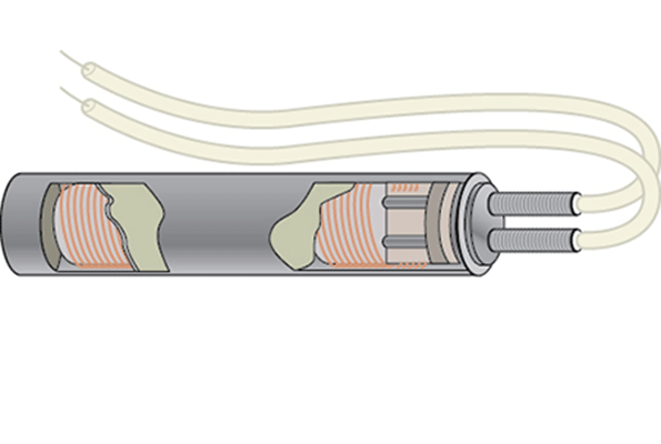

A cartridge heater is an industrial heating element. It consists of an outer metal enclosure called a sheath containing resistive wiring separated from the sheath by electrical insulation. Most cartridge heaters are straight cylindrical tubes and have diameters designed to slide into holes drilled with common English or metric drill sizes. (Some manufacturers advise reaming holes after drilling for high-watt density heaters.)
Typical cartridge heater diameters range from 1 in. (English) or 20 mm (metric) at most down to 1/8 in. (English) or 4 mm (metric).  Smaller cartridge diameters are possible but the wattages are limited by the small surface areas associated with these diameters. Lengths vary by diameter but can range from 8 ft down to less than an inch.
Both cartridge heaters and tubular heaters typically contain resistive Nichrome wire heating elements that are insulated from a metal sheath by MgO insulating material. The heating element terminates at the end of the tube for an external connection point. Cartridge heaters typically use flexible electrical leads which are attached to the cartridge heaters power pins through either an (external) insulated crimp connection or an internal mechanical connection via the swaging process. The electrical connections on tubular heaters are usually through threaded studs or terminals.
A cartridge heater consists of the metal sheath, power pins, resistive wire, insulation, sealing at one end of the sheath, an electrical connection between the resistive wire and power pins, a termination of the resistive wire into wire leads, and the leads themselves.
