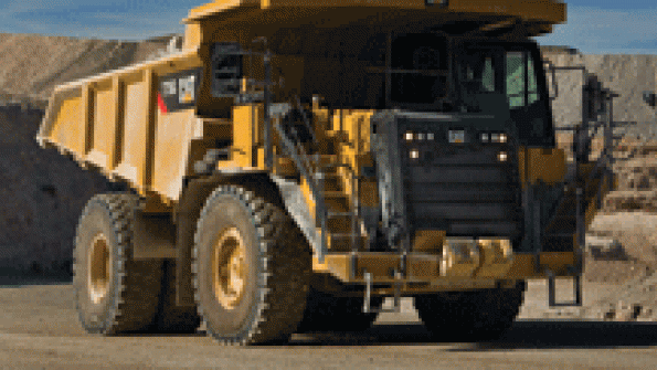

Truck meets Tier 4 final
The new 70-ton 775G o -highway truck from Caterpillar, Peoria, Ill., is powered by a 779-hp Cat C27 ACERT engine that meets Tier 4- nal emissions regulations.
ACERT is Caterpillar’s name for the various techniques it uses to reduce engine emissions. These include, for instance, a high-pressure fuel system that permits multiple injections each combustion cycle, turbochargers that deliver cool air to the combustion chamber, and cross- ow cylinder heads that improve air ow into the engine. In all, the company’s engineers work with about 125 variables in more than 10 million possible combinations to optimize combustion and lower emissions. At the same time, they’re tasked with maintaining or improving engine performance, fuel e ciency, and durability.
To meet Tier 4f limits, the C27 engine also includes EGR NOx reduction and a diesel oxidation catalyst. It requires the use of ultralow-sulfur diesel fuel, but not a diesel particulate lter.
The engine and a new drivetrain are said to increase power 5% over the company’s previous model, letting it hold a higher gear when climbing steep grades. Target gross weight of the truck is 246,500 lb. It goes into commercial production in the fourth quarter of 2011.
