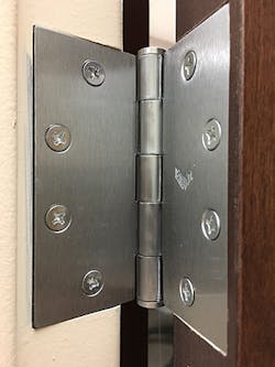

3. A leaf hinge with its five knuckles and the body of the hinge pin are simply overconstrained journal bearings. Unlike the crankshaft, this application uses loose tolerances, low speeds, and low cycles to achieve an acceptable service life.
On the other end of the precision spectrum, we have door hinges. In this case, overconstraint is in layers.  First, a hinge usually has three knuckles where the hinge pin sits, and two knuckles on the door side (Fig. 3). On top of that, most doors have three sets of hinges. Finally, the hinges are mounted by their leaves to the door on one side and the jamb on the other side, both often made of wood.
So why are door hinges obviously successful despite these seemingly large design oversights? The answer lies in the application. The speed of rotation is very slow and the life, in terms of number of cycles or revolutions, is relatively low. In addition, the clearance between the pin and the knuckle is large (compared to precision machinery), thus allowing a considerable degree of misalignment. Finally, the stiffness of the rotating member (door) is fairly low, allowing it to absorb misalignment (deform) without creating catastrophic forces on the hinges.
