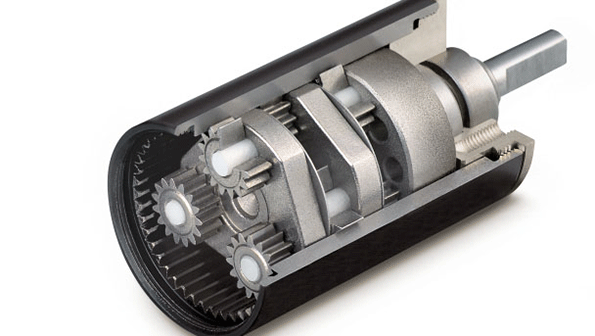

When choosing an alternative material for gears, ceramic and metal injected materials have become popular choices. The simple reason why is that for small-size applications that need to be highly wear-resistant, ceramics and metal injection pieces can be manufactured in large batches and are easier to produce than typical steel alloys.
The gearhead above from Maxon Motors uses a ceramic axis which has a max continuous torque of 0.5 to 2.0 Nm and longer lifetime against wear when compared to metal alloys.
