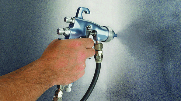

Adhesives, like mechanical fasteners, are easy to apply or install manually. And like mechanical screws and rivets, applying adhesives can also be automated. This is a growing trend as engineers across industry lines are always looking to lower production and labor costs and increase quality and consistency. Even the application of two-part adhesives can be automated using specially designed cartridges. These cartridges use dispensing applicators and static mix nozzles to ensure the adhesives are precisely and thoroughly mixed in exact ratios at the touch of a button.
