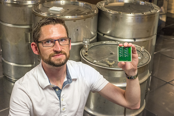

A researcher holds a SecuitySeal, a device that uses physical unclonable functions for detecting tampering on containers of a variety of shapes and sizes.
The seal uses physical unclonable functions, the small defects that are part of any manufacturing process and which creep in due to variations in materials’ properties and tolerances. The current prototypes are about the size of a credit card and are covered by a film containing a suitably complex circuit. The resistances of the circuit changes if someone tries to lift, slide, or remove the film. A digital reader can check the seal remotely, but it needs a private key that will generate the right response from the seal. If the seal has been tampered with, the key changes, and the seal will not provide the proper response, letting users know there has been tampering with the seal.
