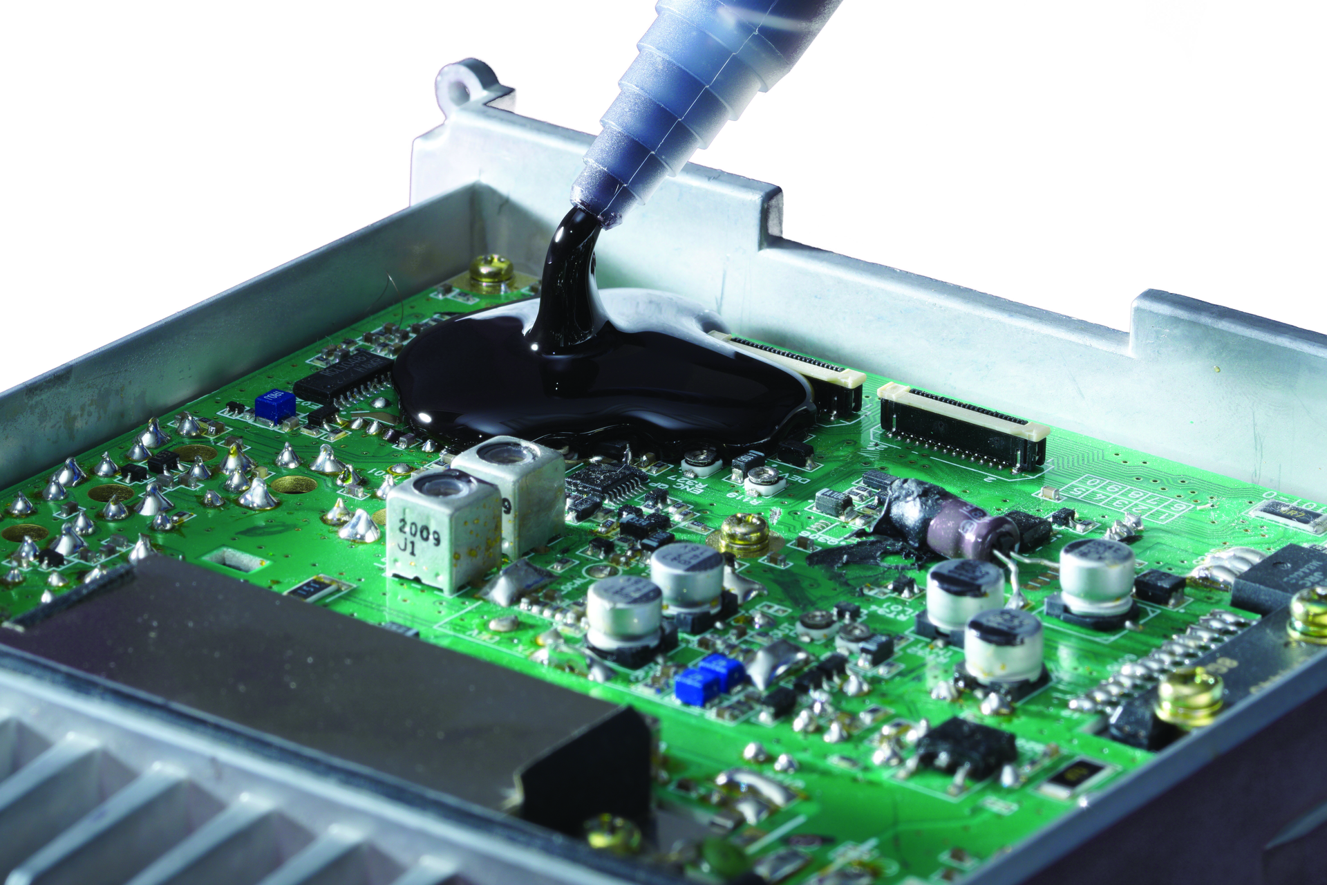

Bad mixes can also trigger highly exothermic reactions, ones that give off heat that damages nearby components or cause out-of-control shrinkage. These reactions can be especially costly if they ruin circuit boards with expensive components already installed, which is a distinct possibility because potting compounds are typically applied last.
An improperly mixed adhesive can also trigger exothermic reactions, and the heat they generate can be especially costly if it ruins populated circuit boards.
