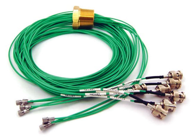

Custom-built sealed wire feedthroughs can be better alternatives. Such feedthroughs pass conductors in a wire harness though walls with no loss of pressure or vacuum, thanks to a hermetic epoxy seal. They also eliminate the voltage drops and contact-resistance issues that can plague connectors. And when used in the right applications, feedthroughs, despite being custom-made, boast a lower installed cost than comparable bulkhead connectors. Often, these advantages give engineers the design flexibility needed to come up with the best design—flexibility not available with bulkhead connectors.

Continuous wire feedthroughs, by contrast, can accommodate thousands of conductors or just a handful, despite being more compact. This density advantage often means one feedthrough can replace several bulkhead connectors. And feedthroughs don’t jut out from bulkheads the way connectors do. As a result, feedthroughs take up less precious space inside pressure chambers and other tight spaces. This can give technicians more room when moving machine parts inside or outside the chamber.
Equally important, continuous wire feedthroughs let engineers mix-and-match conductors, something off-the-shelf connectors do not. For example, magnetic-bearing applications tend to combine twisted, shielded pairs with thermocouple pairs, a combination that would degrade the signals in most bulkhead connectors.
