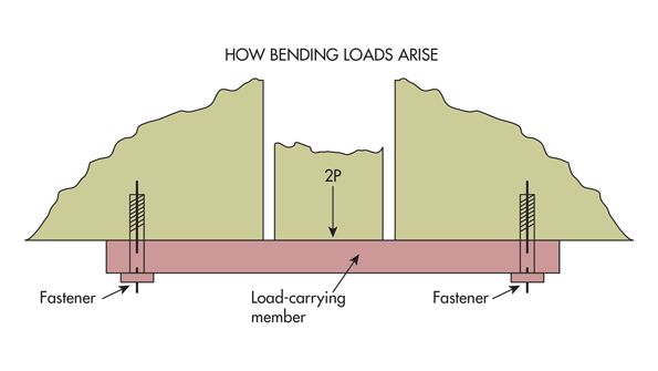

Fasteners installed near the ends or edges of load-carrying members often have hidden loads greater than the actual applied load.
Fasteners installed near the end or edges of load-carrying members often carry more than just the applied load. They also carry a hidden load generated by bending moments in the load-carrying member. This additional load may outweigh the applied load by a great deal.
When a central, load (2P) is imposed on a load-carrying member that is fastened near both ends, the ends of the member tend to curve up. Restraints imposed by abutting member create bearing loads that add to the load carried by the fasteners. Such bearing loads may be significantly greater than the applied load.
If the load–carrying member in the image below were infinitely rigid, the fastener would be required to resist only the applied 2P. But in most applications, a different loading condition develops. The flexibility of the load-carrying member typically demands that is edges or ends resist angular rotation caused by local loads.
For this analysis, bearing loads are assumed to be at a maximum at the edges, tapering to zero at the fastener centerline with a triangular load distribution. Under these conditions, fastener loads and stress are from:

A 5-in-wide bar is centrally loaded with a force of 10,000 lb. The distance between fastener centerlines is 36 in and the bar extends 2 in beyond the fastener centerline at each end.
To use these equations, M, the resistive moment created by the bearing load, is conservatively set equal to the bending moment needs to maintain a fixed-end constraint of the load-carrying member. Then the first equation determines the maximum bearing stress and the second equation determines the resultant bearing load on the fastener.
Example: A 5-in wide bar is centrally loaded by a force of 10,000 lb and restrained at each end by a fastener passing through a hole with a radius of 0.5 in. The distance between the holes’ centerline is 36 in and the distance between the fastener centerline and the bar end is 2 in. What are the maximum bearing stress and maximum load on the fasteners?
