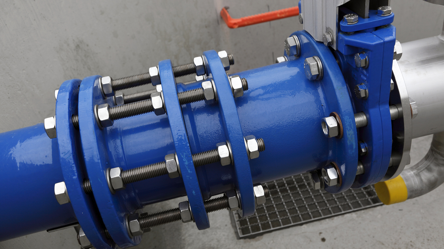

One of the most critical factors in determining the reliability of a threaded-fastener joint is the force the tightened fastener exerts on an assembly, which is known as preload. And preload depends on several variables: fastener material, finish, head style and lubrication.
This complexity means there is no simple, 100% reliable way to calculate the exact amount of preload needed in an application. Fortunately, there are equations that can assist in understanding the relationship between preload and three of the more important factors in threaded joints: bolt load, tensile stress and tightening torque.
