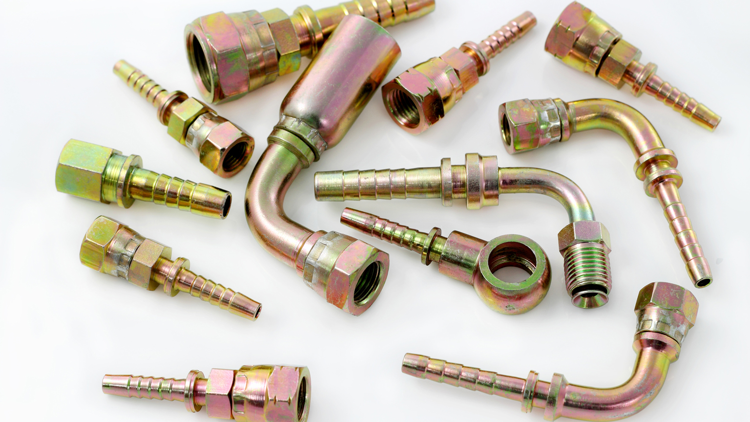

Using the correct thread is critical for proper mating and replacing hydraulic fittings. First and foremost, it is a safety issue. Correct assembly maintains pressure and reliably seals a fitting or adapter, making it safe for humans and equipment, not to mention the environment. It also prevents costly and time-wasting maintenance to cleanup  and replace damaged parts.

1. Determine if the thread is tapered or parallel. Sometimes all you have to do is examine them. Tapered threads get smaller in diameter toward the end of the fitting; parallel threads have the same diameter from end to end. If this is not obvious just by looking at the fitting, use the parallel jaws of a caliper, for example, to make a more exact comparison. An O-ring or tube nut can usually help show if threads are parallel.
READ MORE: The Basics of Threaded-Forming Fasteners for Plastics
2. Determine pitch. Pitch is defined in terms of threads per inch (TPI) or distance between threads. For metric threads, pitch is the distance between threads (mm). A pitch gauge is useful for comparing threads. Here’s a tip: It is easier to compare threads against a lighted background with a pitch gauge. Because some thread pitches are nearly identical, try several gauges before deciding on the one that work best. (Possible pitches are shown in the second column of the “How to Identify Threads” table.) Or you can revert to the simple but demanding process of measuring how many threads are in an inch.
3. Determine size. There are two methods for sizing threads: one for pipe threads and one for non-pipe threads. For pipe threads, determine nominal size by comparing the part against a size profile. A good rule of thumb for pipe sizes up to 2 in. nominal is to measure the OD and subtract ¼ in. Round off for the nominal pipe size. For non-pipe threads, measure the major diameter (OD) of the threads with a caliper.
4. Designate the thread. This final step is not part of the identification process; it’s a way to designate thread types in a standard format. Designations should indicate thread size (nominal or actual), type and, in some cases, pitch.
