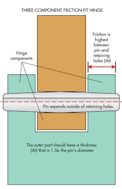

For a friction-fit hinge, there must be spring tension and, therefore, friction, between the pin and each hinge component. But that frictional force is typically greater on one component than the other. So when the hinge rotates (that is, torque applied to either component), the pin remains stationary in one component as the hinge opens or closes. This component is said to be exerting “primary retention.”
To maximize friction in a friction-fit hinge, holes should all be precision matched in terms of diameters. (This is commonly done by drilling or reaming all of the holes in one operation rather than separate steps.) The pin then uniformly exerts tension on all hinge components.

General guidelines
For a typical three-component hinge, the minimum thickness of the outer components should be 1.5× the pin’s nominal diameter. (The nominal diameter is the installed diameter.) But if the outer components’ thicknesses are less than that, then the retention hole should pass through the middle component. And because the pin compresses as it goes through the hole, the end that is pushed through (the sized end), will be smaller than the other (unsized) end. For a free-fit hinge, holes in the outside components should then be set to the measured diameter of the unsized end plus a clearance factor, usually 0.001 in. This usually means a technician will have to put a similar pin through a prototype of the middle component.
