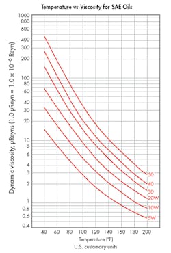

With the high levels of friction and temperature associated with journal bearings, hydrodynamic lubricant systems are able to control temperature of the lubricant, bearing, and shaft (some systems may include a heat exchanger or chiller for the oil). While hydrodynamic lubrication is common, the application and load is important. If the machine will experience a lot of starting and stopping, it’s important to keep in mind that the shaft will rest on the bearing when stopped. Kinetic coefficient of friction between the materials will affect wear during startup.
Petroleum oils are often designed to operate around, or under, 160˚F to combat oxidation. However, one of the biggest reasons for temperature control of lubricants concerns viscosity. Dynamic viscosity is imperative to bearing performance, and it changes with temperature. Viscosity is expressed in lb*s/in.2 (knows as a Reyn, named after Osborne Reynold for his significant work in fluid flow) or Pa*s in SI units. Some engineers will express it in centipoise.
1.0 lb*s/in2 = 6895 Pa*s
1.0 Pa*s = 1000 centipoise
