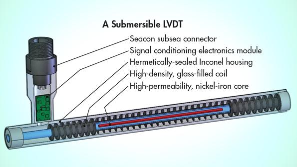

Submersible LVDTs (IP 68)
Submersible LVDTs with a Seacon-Branter mating connector are rated at IP 68. The connector and mating plug are rated for pressures to 5,000 psi or higher. These LVDTs are typically designed with a 20-year life for use in critical applications where access to the unit for replacement or repair is costly. They are recommended for applications involving immersion in fresh or salt water—among them, monitoring mooring cables, dams, and bridge structures; monitoring underwater oils and gas valves and devices; and providing position feedback on unmanned submersible vehicles.
