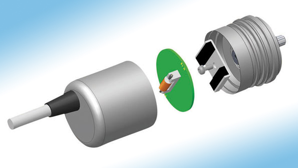

These IXARC magnetic encoders withstand harsh environments and are modular for maximum versatility.

Within some encoders, rapid changes in magnetic polarity generate pulses of current in a coil wrapped around Wiegand wire. Shown here is one full cycle of a Wiegand pickup’s reaction to the magnetic fields.
Another type of revolution counter uses energy harvesting based on the Wiegand effect, the current generated by two-layer ferromagnetic Vicalloy wire when subject to a magnetic field. This wire, made of cobalt, iron, and vanadium that’s cold-worked and hardened to hold a crystalline structure, exhibits high magnetic hysteresis when subject to a sufficiently strong magnetic field, and magnetizes. If the direction of the external magnetic field changes (due to rotation of nearby permanent magnets, for example) the wire’s magnetic polarity initially stays the same but “flips” when the change in the external field reaches a critical threshold.
In encoders with Wiegand-based coils that count multiple revolutions, this change in magnetic polarity generates a current pulse in a copper coil wrapped around the Wiegand wire. As the external field continues to rotate, the wire’s polarity eventually flips back, generating a second pulse. These pulses provide enough power to activate the rotation-counting circuit.
Encoders with Wiegand-based coils track multiturn absolute position don’t need an external power supply. The counting electronics are nearly always in a dormant state, except when the shaft moves enough to trigger a polarity flip in the wire. Electronics analyze the rotating direction and record the revolutions. In this way, encoders with Wiegand-based coils avoid the disadvantages of encoders that run off batteries — including limited lifespan, extra weight, and substances that complicate disposal. The all-electronic counter also eliminates the need for gears used in most optical encoders.
