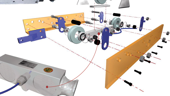

This scale uses a double-ended shear beam to measure static and running cable tension. The cable feeds through the roller set to transmit force to the shear beam. Then a digital readout converts output into weight readings.

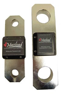

Tension links: Tension links, also called a tension cells, consist of two steel padeyes and a center body housing the load cell. They measure the force in cables, chains, and pulleys, and are most common in lifting, pulling, and winching applications on cranes and wire tensioners on safety cages used in mines. Standard tension links measure 25,000 to 100,000 lb, though custom versions can measure more.

Shear beams: Just like load pins, these measure shear stress. Single-ended shear beams — cantilevered sensors to which load is applied at the free end — weigh loads in blenders, hoppers, and floor scales. Double-ended shear beams — sensors supported at both ends and the load is applied at the middle — weigh tanks and items on large-capacity platforms. Both single and double-ended shear beams operate like load pins in that they incorporate a solid web in an otherwise-hollow beam. Strain gages mounted on the web measure load via shear stresses. Standard shear beams detect loads to 40,000 lb in 20 to 40‑lb increments.

Tension links, load pins, and shear beams are rugged but must be precisely installed. Their load cells deflect predictably only when properly aligned to the applied load and surrounding machinery. Otherwise, skewed loading and moments cause incorrect readings, and oversupported load cells yield less than their expected outputs.
For accurate readings from shear beams and load pins, use the brackets and pins that come with them. Where applicable, carefully choose fasteners. For example, a design may need countersunk bolts to secure the sensor to the machine, especially if the heads are at risk of being sheared off by nearby equipment during operation.
