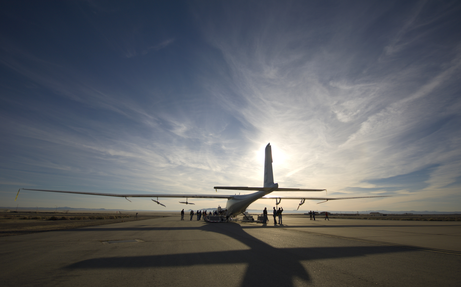

NASA, to test the wing load distribution and wing deflection of the Global Observer aircraft in NASA Armstrong’s Flight Laboratory, has used FOS. The benefits of a FOS installation for this type of application are numerous. For instance, FOS technology provides strain measurement using thousands of spatially continuous sensors. This ensures maximum coverage from a single lightweight optical fiber. As FOS is immune to electromagnetic interference (EMI), radio frequency interference (RFI), or other electrical influences, these systems are ideal for use in hazardous environments and rugged applications, such as flight. FOS can be significantly less cumbersome to install than other sensing technologies. However, while the benefits of FOS are numerous, historically the initial cost of installing a system and lack of awareness has slowed mass market adoption. Moving forward, we anticipate reduction in the cost of FOS systems by 20% to 30% over the next five years, which will open up new opportunities in the automotive, medical, aerospace, and energy markets.
1. The Global Observer (shown above) wing was instrumented with fiber optic sensors under 100% of design load during ground testing. (Photo credit: Center for the Study of the Drone)

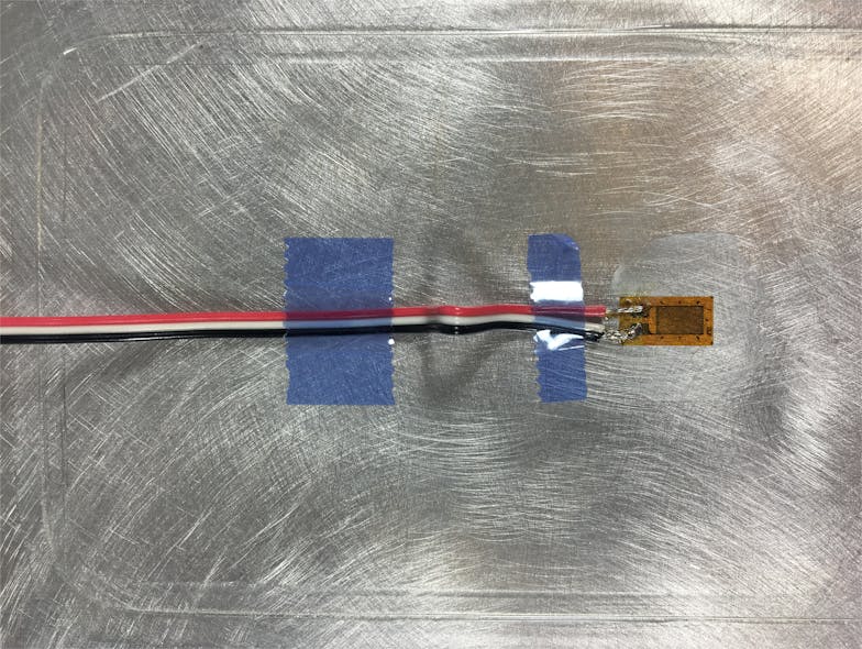

FOS technology can provide engineers with accurate, real-time data on strain fields, load distributions, and residual strains resulting from overloading. Fiber optic sensors are resistant to temperatures ranging from cryogenic (< -150°C) to upwards of hundreds of degrees Celsius. This enables embedded fibers to be monitored during the high temperature cure phase of composite fabrication to determine the through-thickness residual stresses and strains. Because optical fiber is a ceramic and not a ductile material, its fatigue life far surpasses that of strain gauges and it does not exhibit hysteresis. For these reasons, continuous monitoring of composite structures can have far-reaching advancements. For example, commercial airlines will always know the state of fatigue damage on critical components, allowing them to fine-tune maintenance schedules and minimize aircraft downtime.
3. An installation comparing one resistive strain gauge to approximately 50 FBG sensors. The fiber is the transparent line adhered around the strain gauge.
