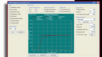

Comparison of algorithms
PID control is limited, as it depends on a plant model, so is sensitive to real-world parameter variations and disturbances such as motor and load inertia changes. In contrast, sliding-mode algorithms have a much simpler control structure. Unlike other advanced servo algorithms (such as pole placement with a Kalman filter) sliding mode control structure is simpler. Its performance and ease of use are comparable to that of competitive technologies.
Another advantage of sliding mode control is that the majority of applications need only manipulate one parameter to achieve optimal performance making it easier to use.
The sliding mode gain Ks is the primary tuning parameter and is related to system inertia: If inertia is increasing, Ks should also increase. However, additional parameters are available to fine-tune even the toughest applications.
Parker Hannifin's Aries drives are capable of tuning and sliding-mode control. Results illustrated in this article were obtained with an Aries AR04-SE drive and MPP0923D servomotor. Visit parkermotion.com for details.
